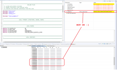

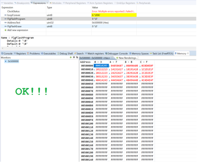

  After putting the function call inside a for(;;) in the main translation unit, I try to update the address 0x500000, w/o any problem

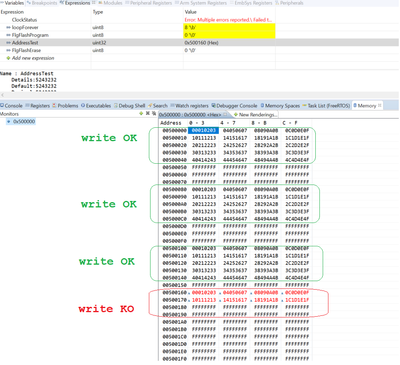

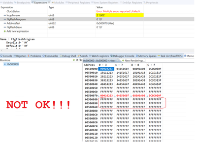

Calling the API a second time on address 0x500070 with the same input source, this is the result
It seems like the C40 driver does not write four lines of Flash.

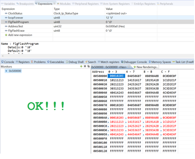

Then I use the address 0x5000A0, and the driver works as expected
I have repeated multiple tests using different address, and sometimes not all the flash lines are programmed as expected. In the picture below you could find the flash layout after 80 bytes programming on 0x500000/500080/500100/500160

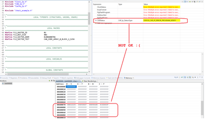

unfortunately, I can not say the same when I change the FLS_SECTOR_ADDR
If I change both FLS_SECTOR_ADDR and FLS_BUF_SIZE the scenario is still errored

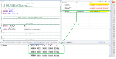

So, am I calling the cache invalidation in the wrong point or with wrong parameters?

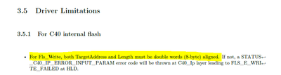

I have also read these lines in the RTD_FLS_UM
Is it a driver implementation or actually a Flash Hardware limitation?

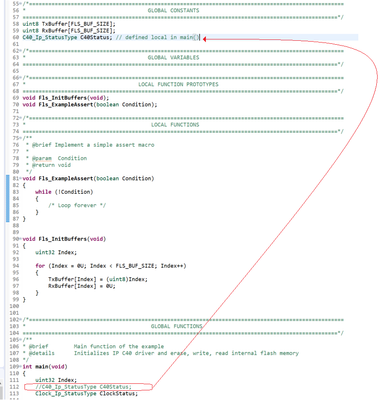

The two difference with the demo are:
  1. C40status is not local in main(), but global for watching with OpenSDA debugger.
  2. FLS_SECTOR_ADDRESS for trying to write Flash at 0x00600060ziomocci_2-1666606671813.pngziomocci_2-1666606671813.png

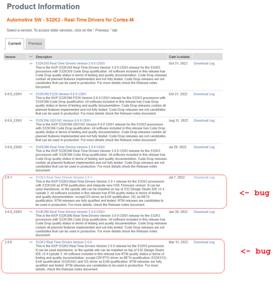

Anyway, it seems like we have to use the RTD version 3.0.

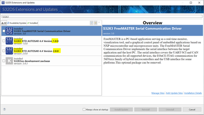

But how could I retrieve it? I have installed S32DS Version: 3.4 Build id: 201217 (Update 3) in my laptop and these are the available packages
RTD ver.3.0 for S32K3 target is not listed.
Same problem if I take a look to the download page from NXP site
Sw list appears a bit confused I am sorry.
So, could you give me a valid download link for last version of S32K3xx C40 Ip Real Time Drivers?
