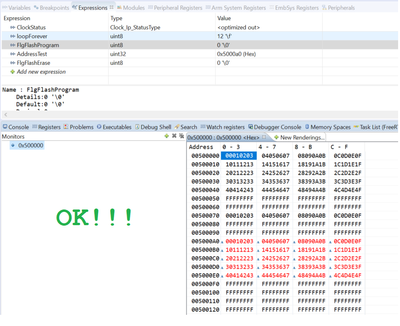

Hi all,
As usual, we need to performs multiple Flash Program operation during, for eg, ECU firmware updates.
Below the interface
sint16 FLASH_Program (uint32 address, uint32 size, uint8 * source)
sint16 res = 0;
C40_Ip_VirtualSectorsType virtualSector = 0u;
C40_Ip_StatusType C40Status = STATUS_C40_IP_SUCCESS;
    /* Get virtual Sector number from address */
    virtualSector = C40_Ip_GetSectorNumberFromAddress(address);
    /*      USE MAIN INTERFACES FOR FLASH JOBS          */
    /* Unlock sector if needed */
    if (STATUS_C40_IP_SECTOR_PROTECTED == C40_Ip_GetLock(virtualSector))
        C40Status = C40_Ip_ClearLock(virtualSector, FLS_MASTER_ID);
        if(STATUS_C40_IP_SUCCESS != C40Status)
            return(sint16)C40Status;
    /* Write data */
    C40Status = C40_Ip_MainInterfaceWrite(address,size,source,FLS_MASTER_ID);
    do
        C40Status = C40_Ip_MainInterfaceWriteStatus();
    while (STATUS_C40_IP_BUSY == C40Status);
    /* Re-lock sector after program operation */
    C40Status = C40_Ip_SetLock(virtualSector,FLS_MASTER_ID);
    return(res);
  After putting the function call inside a for(;;) in the main translation unit, I try to update the address 0x500000, w/o any problem

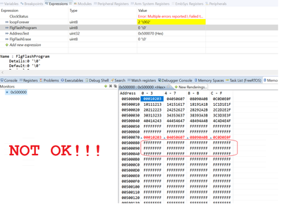

Calling the API a second time on address 0x500070 with the same input source, this is the result
It seems like the C40 driver does not write four lines of Flash.

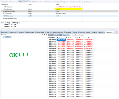

Then I use the address 0x5000A0, and the driver works as expected
I have repeated multiple tests using different address, and sometimes not all the flash lines are programmed as expected. In the picture below you could find the flash layout after 80 bytes programming on 0x500000/500080/500100/500160

Hello Andrea,
There is a bug in RTD 2.0.0 and 2.0.1 that has been fixed in RTD 3.0.0.
Have a look at Section 20.5.1.2 in the RM rev.4.
"Up to four pages can be programmed at once on a quad-page boundary. The program operation
consists of the following sequence of events:"
Section 20.2.1
"The embedded flash memory is addressable by page (256 bits) for read operation and double-word(s)
and page and quad page for program operations."
Up to four pages (maximum 128-byte of the program data buffer) can be programmed at once on a quad-page boundary (aligned with 128-byte as well).
This means the data to be written must fall within a quad-page.
In the new release RTD 3.0.0, there is a condition check for Address Offset + Length <= C40_DATA_SIZE_BYTES_U32 (128 Bytes).

danielmartynek
Hello Andrea,
The 3.0.0 version has not been released yet.
You can use the version you are using now, but you need to write the flash with 0x10, 0x20 or 0x40 writes.

danielmartynek
I see the next release scheduled for Q1/23.
But even with the new release, you would need to properly align and size each of the writes, otherwise the new condition in the driver would return an error. So, this is something you can do with this release too.
