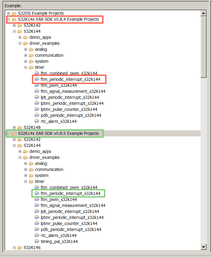

I am using S32K144EVB.
I am using ftm_periodic_interrupt Example code which are provided by NXP.
while building the project i am getting an ERROR. I have attached the screen shot of that ERROR.
Let me know how to resolve this issue?

I have tried with FTM_DRV_ClearTimerOverflow() it is compiled properly.
But when i am running the project it is not generating a Interrupt.
When i further debugged my code it is stopping due to FTM_DRV_Reset(ftmBase); which is called from FTM_DRV_Init() function.

danielmartynek
Could you just use the example form SDK v0.8.5, instead of SDK v0.8.4?
The v0.8.5 example is functional.

danielmartynek
Could you use FTM_DRV_ClearTimerOverflow() function instead?
