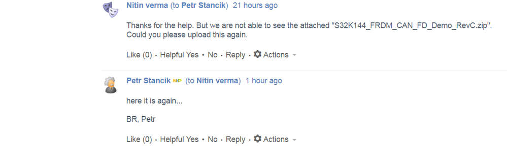

nitinverma
Thanks for the help. But we are not able to see the attached "S32K144_FRDM_CAN_FD_Demo_RevC.zip". Could you please upload this again.
12,847 Views
PetrS
here it is again...
BR, Petr

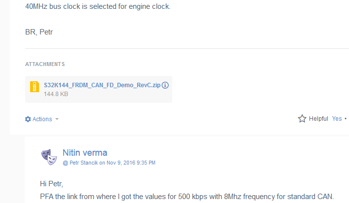

PetrS
Hi Nitin,
Your bit rate setting is not correct, or better does not follow CAN standard. It can work, but it is not CAN standard compliant.
See attached simple example configuring CAN module to send FD message. The bit timing config is dine in InitCAN() function. A 40MHz bus clock is selected for engine clock.
BR, Petr
12,847 Views
nitinverma
Hi Petr,
PFA the link from where I got the values for 500 kbps with 8Mhz frequency for standard CAN.
http://www.bittiming.can-wiki.info/
Here the device I have selected as NXP(Freescale)FlexCAN, and got the following mentioned values.
Now, I need the values for CAN FD with data phase as 2mbps and clock is 8Mhz. As per your reply I did not find any attached example,Can you please send it once again.
Nitin
