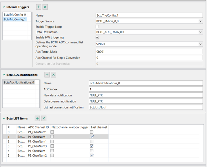

We are using NXP senseless BLDC code ( S32k344) for our custom design hardware  where the PWMs are exactly the same as NXP eval board but the ADCs are different as follows:
Below is NXP ADCs :
Here is our ADC pins:
BEMF_A : PTE25 ( adc2_p7)
BEMF_B: PTE0 ( adc1_p2)
BEMF_C: PTA20 (adc2_p2)
DCB_V: PTD0 ( adc0_p1 )
DCB_I: PTE7 ( adc2_s20)
We have gone through the user guides for the sensorless firmware as well as the FOC like AN13767 but still having issues with the Bctu list items. Basically we need to know what the new Bctu list items wou;d be with the new ADCs mentioned above. Appreciate your URGENT support.

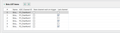

Senlent
Hi@Eduardo2000
1.In the demo "MCSPTE1AK344_BLDC_6Step_sensorless_ll"
You can see the adc sample sequence is as below shows:
eMIOS0_CH3->ADC0_P0 DCB_I(SINGLE)
eMIOS0_CH2->ADC0_P1,ADC1_P1 DCB_V,BEMF_A(LIST)
eMIOS0_CH2->ADC0_P1,ADC1_P3 DCB_V,BEMF_B(LIST)
eMIOS0_CH2->ADC0_P1,ADC1_P2 DCB_V,BEMF_C(LIST)

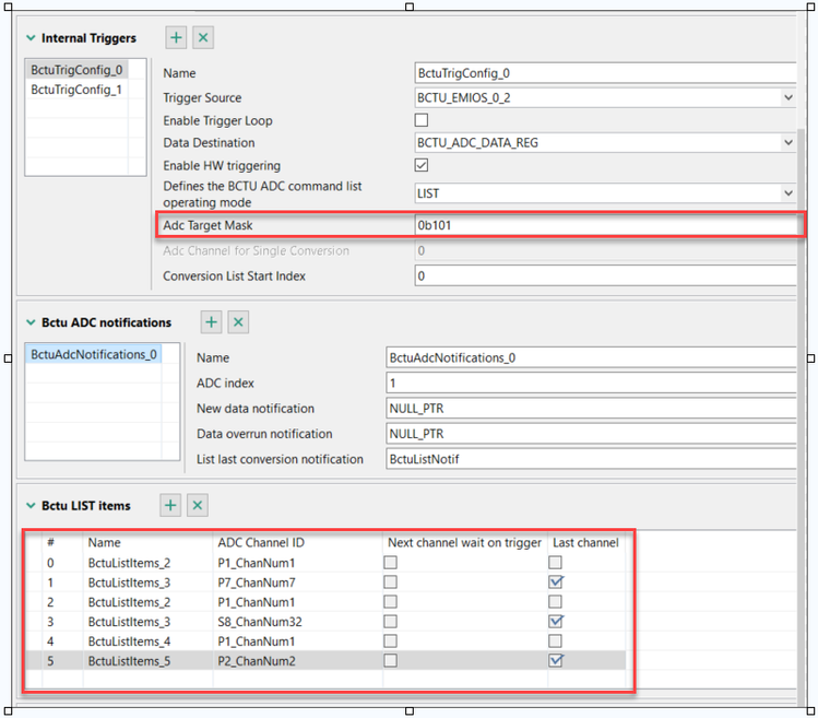

2.According to your new ADC port changes.
A.For BCTU LIST->

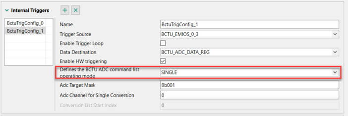

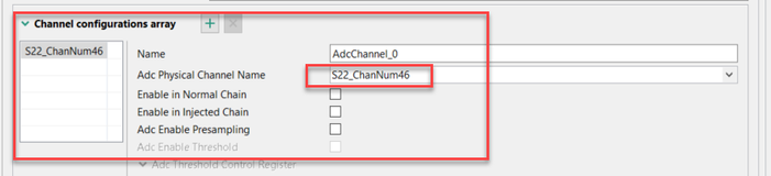

B.For BCTU SINGLE
Senlent_2-1728539541954.pngSenlent_2-1728539541954.pngSenlent_3-1728539547151.pngSenlent_3-1728539547151.png
eMIOS0_CH3->ADC0_S22 DCB_I(SINGLE)
eMIOS0_CH2->ADC0_P1,ADC1_P7 DCB_V,BEMF_A(LIST)
eMIOS0_CH2->ADC0_P1,ADC1_S8 DCB_V,BEMF_B(LIST)
Also, the ADC instance for the temperature sensor should be modified as well.
