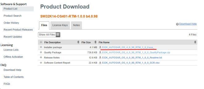

Hello:
I'm developing an ECU project using the S32K146 chip with the Autosar architecture. I haven't been exposed to the usage of the Os module before and would appreciate it if you could provide me with some example routines related to the Os module.
Thank you!

There is one example in AUTOSAR OS package:
You will find it in your NXP SW account:
S32K_AUTOSAR_OS_4_0_98_RTM_1_0_0.exe_
It is pretty intuitive, you can configure it just from User manual AUTOSAR_OSS32K_UM.pdf which is part of the package.
