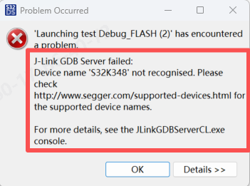

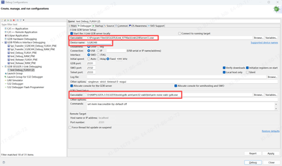

An error occurred while debugging with J-Link, as shown in the figure. How should I resolve this error?

Hi @baibi,
Which version for SEGGER SW are you using? As mentioned in this other community post (Solved: S32K344 J-Link GDB Server failed: Device name 'S32K344' not recognised), if version is too old the device may not have been added yet to the firmware.
I can see from the Release notes that support for S32K348 was added in Version V8.46.
Julián
