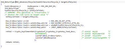

I am trying to advance lifecycle of the board from CUST_DEL to OEM_PROD. For this I am using HSE_SRV_ID_SET_ATTR srvid and attribute is hseAttrSecureLifecycle_t. still I am getting HSE_SRV_RSP_INVALID_PARAM.
Can you please help me with this?
Microcontroller: S32K312
SDK: PlatformSDK_S32K3_2022_03

Please find below snap for advancing LC.
Also, I have provisioned ADKP. I am getting positive response from HSE. Is there any other way to confirm this?

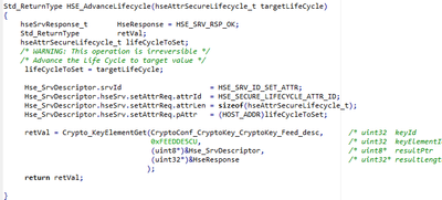

If it is possible could you share your code?
3,391件の閲覧回数
shravani
Hi @VaneB
Please check below snaps for the code
3,354件の閲覧回数
shravani
Hi @VaneB ,
solved this issue by placing parameters in non cacheable memory
