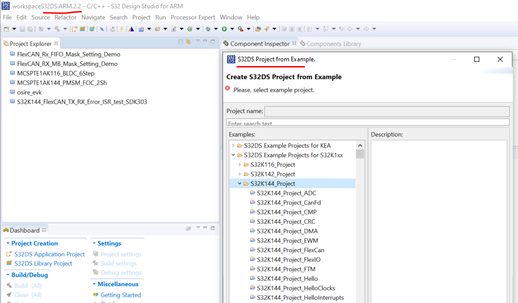

duong
how can I find other demo code in s32

Senlent
Hi@duong
If you have S32 Design for Arm V2.2 installed, you can find a similar demo.
For your convenience, I have upload the demo in the attachment for your reference.
