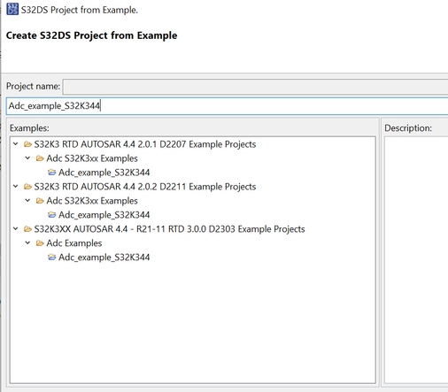

Which package I should install to have Adc_example_S32K344 available.
I have S32K3X4EVB-Q172 board and have installed:
SW32K3xx.S32DS_3.5.0_D2303.zip,
SW32K3_RTD_4.4_R21-11_3.0.0_CD04_D2212_updatesite.zip, and
SW32K3_RTD_R21-11_3.0.0_P07_D2306_DS_updatesite.zip,
I only see Adc_example_S32K311 available.
Gary
I am able to get Adc_example_S32K344 now after install "SW32K3_RTD4.4_R21-11_3.0.0_D2303",

This is no longer an issue after updated the main.c code., thanks -- Gary
