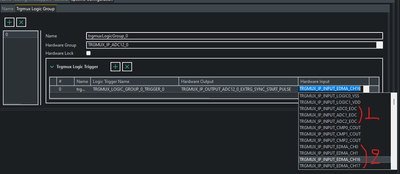

Hello NXP team !
Can someone explain me how this setup is like ??
Please also, can someone explain me how does the ADC0_EOC works ?

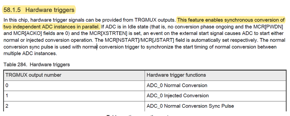

A. Is this trigger enabled in after every end of ADC0 channel conversion ?
B. When does the eDMA 0/1/16/17 trigger goes high in order to trigger the ADC12 NormalConv or SyncStartPulse ?
C. I want with 1 trigger to start a chain of conversion in ADC0 and ADC1. Which signal should I use to do this !? (the TRGMUX_IP_OUTPUT_ADC12_0_EXTRG_SYNC_START_PULSE or TRGMUX_IP_OUTPUT_ADC12_0_EXTRG_NORMAL_CONV ???
D. If I use a DMA channel to be triggered from BCTU or FIFO1. Can I use the same DMA to start a parallel Normal Conversion for ADC0 and ADC1 ?!
Kind regards,
kyf

_Leo_
Thank you so much for your patient and your interest in our products and for using our community.
Regarding your questions…
A. Yes.
B. In both of them.
C. TRGMUX_IP_OUTPUT_ADC12_0_EXTRG_SYNC_START_PULSE
Hope it helps you.
Have a nice day!
