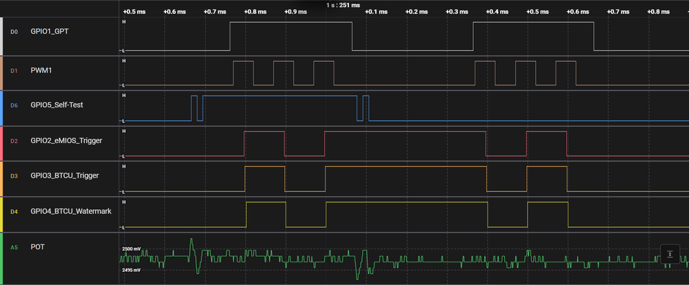

Project Overview
I’m working on a design where ADC sampling is triggered through an eMIOS → BCTU → ADC chain. The BCTU receives triggers from eMIOS PWM channels configured in OPWMT mode to create precise timing offsets between trigger events.
Current Setup
  • ADC0 processes two groups of signals:
    • Group 1 (two ADC channels) triggered by eMIOS_0_CH1
    • Group 2 (two ADC channels) triggered by eMIOS_0_CH2
  • Each signal sample takes about 1.3 µs, so each group requires approximately 2.6 µs.
  • The second group (triggered by CH2) is offset by 3.6 µs (+1 µs margin) to avoid overlap with the first group.

Observation
When I toggle a GPIO in the CH4 callback, it fires as expected. However, running the ADC self-test for a single ADC instance takes about 13 µs (measured in software).

According with 60.3.17.2 Self-test section: Individual steps can take up to 1 µs at 80 MHz ADC clock frequency.
Please find attached example. In practice, I cannot get less than 14us per instance.

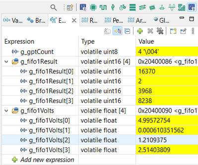

For safety applications, it is important to verify correct operation at regular intervals. But also consider that the ADC Self-Test function should be called at any time after driver was initialized and there are no ongoing conversions.
When you suspend debug session, in Expressions tab you can observe results: g_fifo1Result, which corresponds to the BCTU list measurements, meanwhile g_fifo1Volts corresponds to the conversion in volts.
