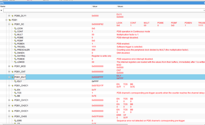

hajianik
Senior Contributor I
Hi Daniel,
As always thanks for your reply.
Here is the issue. I'm dealing with Autosar code and trying to hack it , not with malicious intention of course. so there is 7 ADC1 channels on PDB1, and you can see below the register content. I'm interested in channel 3 (SC1D )to be read on a continuous basis. so I let the AUtosar do its initialization( single shot) and right after that I set the continuous bit to 1. Although I read RD every 1 ms or even 20 ms I don't see the COCO bit  gets updated. when remove the continuous bit setting, it updates for COCO bit.
BR,
Koorosh
8,637 Views
danielmartynek
Hi Koorosh,
I don't use Autosar, please create a new thread for this.
I would use the ADC interrupt or the PDB interrupt to check the COCO and to read the result instead of the polling method that you use though.
