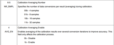

              I  want to do calibrate the ADC results by using  Adc_Calibrate(), I can able to do the 32samples only, not able to change the any other samples .
If i want to change the sample count from 32 to 16 or 8 , whether i need to change the bit position manually in the Adc_Sar_Ip.c?

As far as I know ADC performance specifications are guaranteed when calibration uses maximum averaging i.e. when AVGEN = 1 and AVGS = 3. This is why Adc_Calibrate uses 32 samples. It is not recommended to modify the NRSMPL.
