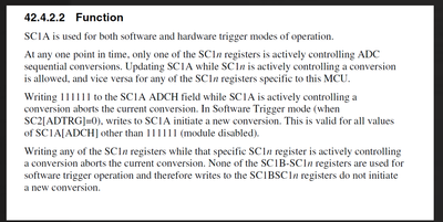

 I have to configure ADC0 to 5 channels and ADC1 to 2 channels
*   ADC0-SE2
* ADC0-SE3
* ADC0-SE6
* ADC0-SE7
*  ADC0-SE10
*  ADC1-SE14
*  ADC1-SE15
How can I trigger all these channels by using software triggering method and read the result

Shruthi_C
HI Robin,
Can we use Software trigger for multiple channels of ADC and a\can we read the results ?
As in data sheet given like this
2,592 Views
Robin_Shen
Sorry for the misunderstanding with my previous reply.
If you have to configure ADC in software trigger mode (when SC2[ADTRG]=0), then you may need to write SC1A[ADCH] values one by one for ADC0 and ADC1 respectively to achieve ADC sample.
But I think you can configure ADC in hardware trigger mode (when SC2[ADTRG]=1), and select PDB trigger ADC. Select software trigger for PDB, writing 1 to PDB_SC[SWTRIG] resets and restarts the counter of PDB.
For more detail please have a look at 43.7 ADC Trigger Sources of S32K-RM.
