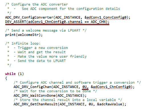

when I USE ADC_DRV_ConfigChan   to config ADC ,  I have a problem about this function
This is the prototype of its function
* @brief Defines the control channel configuration
* This structure is used to configure a control channel
* of the ADC
* Implements : adc_chan_config_t_Class
typedef struct
bool interruptEnable; /*!< Enable interrupts for this channel */
adc_inputchannel_t channel; /*!< Selection of input channel for measurement */
} adc_chan_config_t;
void ADC_DRV_ConfigChan(const uint32_t instance,const uint8_t chanIndex,const adc_chan_config_t *const config)
so,when i want to config adc chanel  11
so i use this
ADC_DRV_ConfigChan(XX,11,XX)
but it can not work !!!!
but i use this
adc_chan_config_t  test ={true,11}
ADC_DRV_ConfigChan(XX,XX,test )
it can work!!!!!!!!!!!!!!!!!!!!!!!!!!!
so,why?  Configure which parameters the channel selects?
3Q

I assume you want to use SW trigger.
Please refer to adc_swtrigger_S32k144 SDK example.
Only channel 0 (SC1A) supports SW trigger.
And you can choose its input (SC1A[ADCH]).
