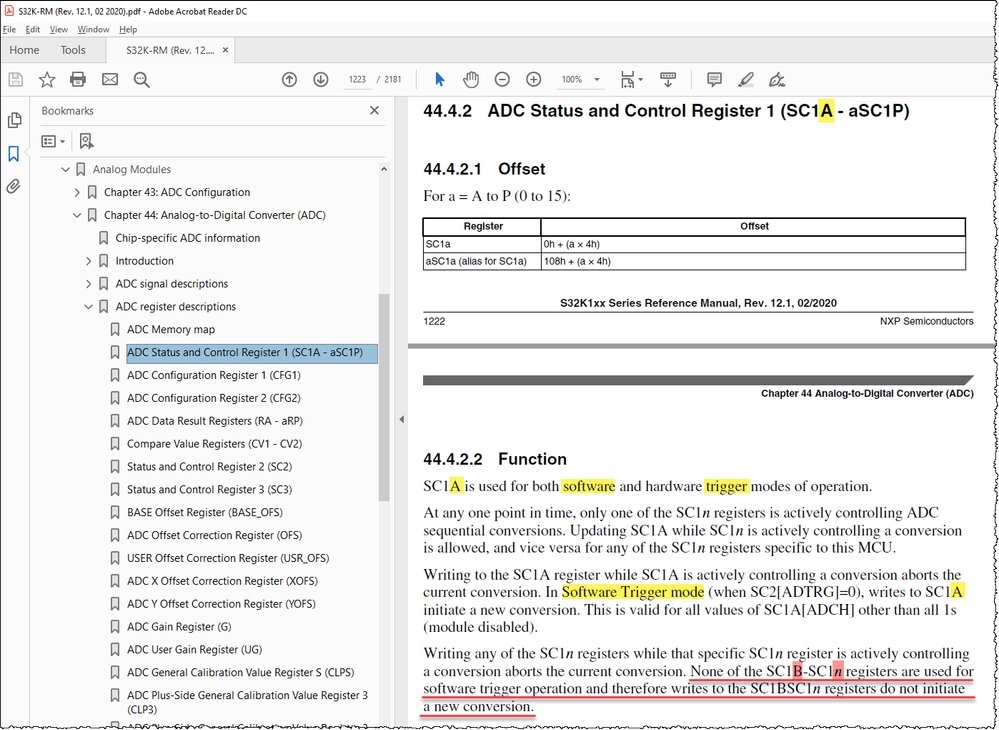

Hi linglei_meng,
In Software Trigger mode (when SC2[ADTRG]=0), writes to SC1A initiate a new conversion.
None of the SC1B-SC1n registers are used for software trigger operation.
ADC Status and Control Register 1 (SC1A - aSC1P).pngADC Status and Control Register 1 (SC1A - aSC1P).png
When using ADC_DRV_ConfigChan you should notice it: When Software Trigger mode is enabled, configuring control channel index 0, implicitly triggers a new conversion on the selected ADC input channel.
Robin
