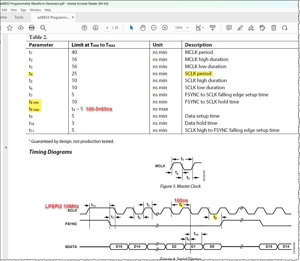

Robin_Shen
As the S32 Configuration Tool indicates for SpiTimeClk2Cs and SpiTimeCs2Clk: This parameter allows to use a range of values ​​from 30ns up to 0.01s. So you can't set SPItimeCs2Clk to 20ns.
The SpiTimeCs2Clk value is out of range. In HW specific the value must be in the range [3E-08 to 0.01].jpg
I don't understand why you have to set SPItimeCs2Clk(t8) to 20ns. As far as I understand, when LPSPI2 operates at 10MHz, the SCLK period(t4) is equal to 100ns. So t8 max=t4-5=100-5=95ns. You just need to set SPItimeCs2Clk(t8) between t8 min and max, which is between 10ns and 95ns.
I just set SpiTimeClk2Cs and SpiTimeCs2Clk to 30ns which is 0.00000003.
AD9833 is not a product of NXP, porting AD9833 - Microcontroller No-OS Driver is out of scope of our online technical support.
Since you don't use MISO pin, it is recommended to enable SpiHalfDuplexModeSupport and use Lpspi_Ip_SyncTransmitHalfDuplex instead of Lpspi_Ip_SyncTransmit.
I modified Lpspi_Ip_HalfDuplexTransfer_S32K358_RTD400HF02 to send the command initialization sequence '0x2100 0x50C7 0x4000 0xC000 0x2000' from the AN-1070 example. Regarding the control of AN-1070 I suggest you also contact technical support at www.analog.com.

Since PTB3 is connected to J63 pin8 (GMAC_RGMII_TXD3_PTB3) by default on the S32K3X8EVB-Q289 board, it is not convenient for me to test it on the S32K3X8EVB-Q289.
Today I found another S32K358 mini board to test your project. The following is the SPI data captured by the logic analyzer. I feel that this data is a bit strange, and the time interval for sending SPI data is too short. I don't know if your application really needs to modify the output of AD9833 so frequently.

Robin_Shen
The following is the SPI waveform after I debugged the AD9833_TX_SPI of your attached project (SPI_ONLY_M7_0_0):
Since my S32K358 mini has a 16MHz crystal onboard, I modified the clock part, and I also increased the values ​​of SpiTimeClk2Cs and SpiTimeCs2Clk.
I found two problems based on the SPI data on the logic analyzer:
1. 0x0000 is sent extra every time. Why did you #define DAC_STACK (4U)? Shouldn't it be 2U?
2. You called AD9833_TX_SPI(0x2100); but sent 0x0021. It seems that you reversed the higher 8 bits and the lower 8 bits. Please modify the assignment of TxMasterBufferAD3988[0] and TxMasterBufferAD3988[1].
10,767 Views

Robin_Shen
The serial clock can have a frequency of 40 MHz maximum.
The maximum frequency mentioned in the AD9833 datasheet does not mean that you must communicate with a 40MHz SPI clock. You can also use a lower SPI clock frequency.
Please note:
For S32K314, S32K322, S32K324, S32K328, S32K338, S32K341, S32K342, S32K344, S32K348, S32K358, S32K388,S32K396: The maximum baudrate for LPSPI0 is 20MHz, for LPSPI1-LPSPI5 is 10MHz, for FLEXIO is 10MHz.
Also, FreqReg is calculated using MCLK, not SLCK

Robin_Shen
