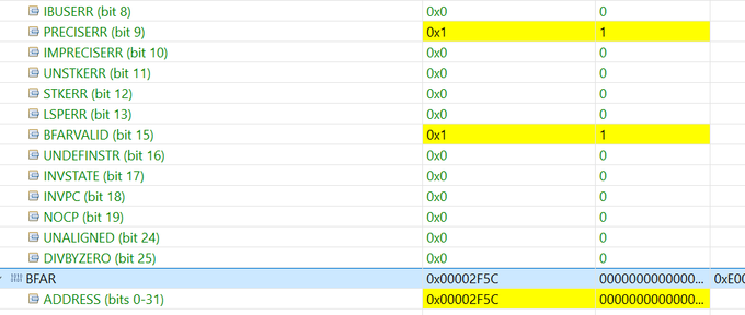

danielmartynek
Hi @pangyun,
Can you please share the project so that I can test it?
What do you see in S32_SCB_CFSR and BFAR registers?
Thank you,
BR, Daniel
2,802件の閲覧回数
pangyun
My project's name  is "mpu_pal_memory_protection_s32k144"  from the example.I only change the adress in the MPU configuration and some code in main.c, I use Debug_Flash,, here‘s  the MPU configuration and the code I changed in main.c, you can test.Thank you!
