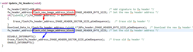

This Update_FW_header() function is from s32k144_fota_bootloader for A/B bootloder functionality.
My question is that why has been old firmware header erased two times???
AND
we are downloading firmware to flash_new_address_block so we need to erase the header present at this address(means flash_new_address_block).Erasing the header at this address is done by 1st erase function which is correct but 2nd erase function is erasing header of firmware where we are not updating new firmware so there is no need to erase the header.

When you check the code you can see that the "Flash_Block_to_Update();" function is called for the first time. This function set flash_new_image_address_block and flash_old_image_address_block.
So, in the "Update_FW_header()" is not erased the same address two times

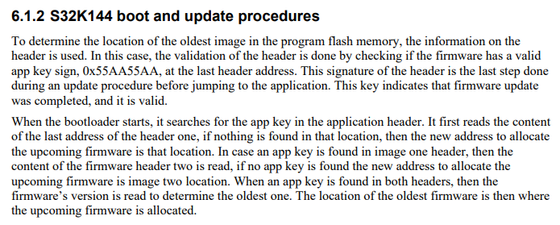

The functionality is described in the AN12323:
Since the app key is stored at the end address of the latest fw header the oldest header is erased.
After that, you can recognize the new one fw from the old one fw. However, the SW is counting with the case that both fw headers have app key as is described in the above excerpt.
