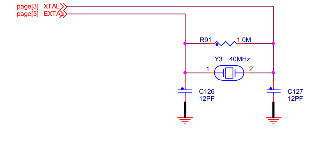

I am trying to build  basic timer application using the Gpt module provided. I am using MCAL 4.3 on S32K118 EVB and using EB tresos and S32DS.
I have set up the McuClockReferencePoint at LPO_CLK_32K and when the frequency is calculated, it is indeed 32000. Then I have set the GptClockReferencePoint_0 to point to this clock, and created a Gpt channel instance named Sample_Timer. EB tresos also calculates the GptChannelTickFrequency as 32000.
However, when I set up my main code to test it, the timer was waaay to fast. So I tried some reasonable large values for overflow. Indeed, when I set the timeout period as 40.000.000 it is overflowing with approximately 2 second intervals.
I am guessing the issue is with the EVB 118 hardware. So even though EB Tresos thinks that there is an oscillator with a frequency of 128Khz, it is not there. I think the only two XTAL's available on EVB are at 8MHz and 40MHz. So I guess I cannot test the LPO functionality with this board?
Is it possible to create a timer with 32 kHz frequency without using prescalers etc.? If so, what am I doing wrong?

Hello [email protected]‌,
I have received the answer from our internal community. Turns out the SOSC in EVB board is 40MHz instead of 8MHz. You can see in the S32K118 EVB schematic:
This also explained why your timer is five time faster than expectation :-)
Nam

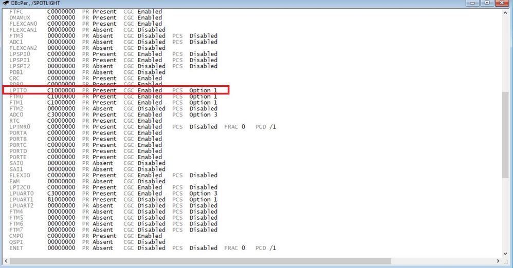

namnguyenviet
Probably the CLK source for LPIT is too much high, leads to CVAL (Counter value) decreases too fast. Please check your PCC and SCG registers:

talha_uyar
I think the register values are the same.
I also think this about me using the wrong clock source. When I call the function Gpt_StartTimer(Sample_Timer, 24000000) it overflows at 1 second. This kind of indicates that I am using SYS_CLK instead of SOSCDIV2 which is at 24 MHz instead of 4 MHz. I cannot understand why, though.
