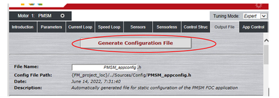

On my proprietary S32K144 (W) board, I implemented NXP's 3-Phase PSMS Sensorless FOC software. I was able to select the parameters for the software using the FreeMASTER's Motor Control Application. The target is a Maxon 48V/0.68A nom 5280 rpm motor. My motor is running, but I have questions about understanding the NXP software.
Motor Speed Control
The "Hardware Scales" - "I max": (I_MAX) should be 1.68 (A). When I use this value, the motor's speed control does not affect the motor rotation speed; instead, the applied DC voltage determines the rotation speed. In this case, the motor is running smoothly and very efficiently.
When I change this I_MAX to 0.001 (from 0.001 to 0.00000001), which only affects the measured phase current representation numerical value, the software has complete control over the motor speed from 0 to +/- nom rpm (with a very slow 100 rpm ramp).
Remarks: the I_MAX is used to set one other variable (U_DCB_MAX/I_MAX), which I replaced with the motor resistance value.
Any comment on this?

Hello Antal,
Thank you for your question. Yes, you are right, the I_MAX parameter isn't sufficiently explained in MCAT tool.
In fact, the _MAX parameter doesn't refer to the maximum motor current.
It characterize the current sense circuit on your board/EVB. So, it is only theoretical current value at which the input ADC voltage = 5V (= maximum measurable voltage). No relation to the real motor or power stage current capability.
Example: Current sense amplifier gain is 20. Shunt has 0.01 Ohm. So, (5 V / 20) / 0.01 = 25 Amps
The same is valid for U_DCB_MAX - it is theoretical value where ADC will measure full range 5V.
So these parameters just specified the ratio between real voltage/current values and ADC measurement results.

Hi Antal,
Here are my comments:
Motor Speed Control:
As Radek mentioned I max and U DCB max are hw scales and they have to be set properly according to gains in your proprietary S32K144 (W) board  in order to be able to measure current and DC link voltage.
If those feedback signals are not measured properly it has an impact on a control algorithm.
Motor parameters (pp, Rs , Ld, Lq …) also have to be set properly according to used motor.
Note: If you make a change on Motor parameters or Hardware scales (MCAT tool card Parameters) the change has to be stored, output file has to be regenerated and application has to be recompiled in order to apply changes.
Motor Current Control
I suppose you are using sensorless. Application operates in 3 modes (Force mode, Tracking mode, and Sensorless mode). In all modes a current is controlled by AMCLIB_CurrentLoop_FLT. Output voltage is adjusted according measured DC link voltage by MCLIB_ElimDcBusRip_FLT. You can find detailed description in AN12235.pdf and Ammclib documentation on standard path C:\NXP\AMMCLIB\S32K14x_AMMCLIB_v1.1.28\doc\ S32K14XMCLUG.pdf.
