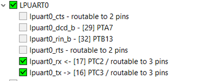

 The purpose of this demo application is to present a usage of the
 UART IP Driver for the S32K3xx MCU.
 The example uses LPUART0 for transmit & receive 20 packets with each packet of 21 bytes using the DMA in cyclic order.
Baudrate : 921600
* Test HW: S32K31XEVB-Q100
* MCU: S32K311
* Compiler: S32DS3.5
* SDK release: RTD 3.0.0
* Debugger: PE micro
* Target: internal_FLASH
