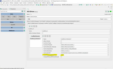

The purpose of this demo application is to present a usage of the
EMIOS IP Driver in Polling mode for the S32K3xx MCU.
The example use to :--
EMIOS-1 - ch-0  --> PTC24 --> Generate the PWM
EMIOS-1 - ch-1  --> PTC25 --> is the ICU channel to measure the duty
Pins used :--
This example is tested for IPWM mode .  :--
IPWM mode ,  ICU Driver User Manual :--
Result :--

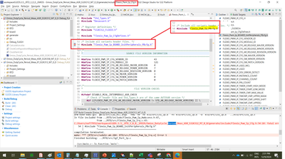

Sometimes Compiling error comes, in Autogenerated RTD file.
Change the Header file name :--
