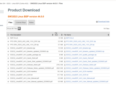

I noticed that the SDK BSP44 has been released, and I tried to build the yocto project following the BSP44 reference user manual. But it failed due to no NXP-EULA license file. And I tried to find the file from the flexra download site, and I did not find it.
So would you please help to check the issue, or where can I get the license file to build the project?

Are you using RDB2 or RDB3? Could you share more error information for us?

Yes, I use RDB3 for test, and the build errors are like:
sources/meta-alb/meta-alb-bsp/recipes-bsp/ddr-firmware/ddr-firmware.bb: Unable to get checksum for ddr-firmware SRC_URI entry NXP-EULA: file could not be found
The following paths were searched:
${NXP_FIRMWARE_LOCAL_DIR}/fsl-auto/NXP-EULA
sources/meta-alb/meta-alb-bsp/recipes-bsp/ddr-firmware/ddr-firmware-1.0/fsl-auto/NXP-EULA
sources/meta-alb/meta-alb-bsp/recipes-bsp/ddr-firmware/ddr-firmware/fsl-auto/NXP-EULA
sources/meta-alb/meta-alb-bsp/recipes-bsp/ddr-firmware/files/fsl-auto/NXP-EULA
The NXP-EULA is a new license of NXP? Where can I get it to make the yocto project build pass?

NXP-EULA can be downloaded here and placed in the above path.
Hope it can help you.
