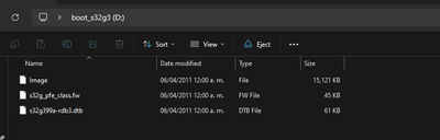

alejandro_e
Hello @hittzt,
I do see several changes in the drivers/watchdog directory, however none of them seem related to NXP products.
Never the less the results of my test stand correct. To clarify I used the precompiled BSP44 sdcard image, then I changed the "Image" file, which is the kenel, to the one in BSP43 (also in the precompiled binaries) this is shown in the only working partition when connecting the sdcard to a windows machine:
You I did not change the DTB or the PFE FW.
With this test the watchdog Linux device worked as expected with the two command you shared previuosly.
Let me know if you are able to see the same behavior,

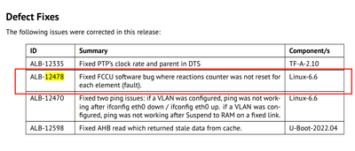

I found that the watchdog issue should be caused by the following commit:
From a565a2439fce7c9ad6c0a41d12c1353928838be4 Mon Sep 17 00:00:00 2001
From: Ciprian Marian Costea <[email protected]>
Date: Tue, 4 Feb 2025 10:55:56 +0200
Subject: [PATCH 941/977] s32cc: fccu: Fix reactions setup and enablement
commit a565a2439fce7c9ad6c0a41d12c1353928838be4 from
https://github.com/nxp-auto-linux/linux
Reset reactions counter for each element (fault) of the reactions list.
Otherwise, when one reaction is enabled, the rest which follow would be
wrongly enabled also, even if 'S32CC_FCCU_REACTION_NONE' is used as
action.
Issue: ALB-12478
Signed-off-by: Ciprian Marian Costea <[email protected]>
Would you please help to check and give a fix to the issue?
Zhantao

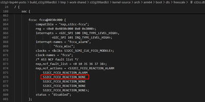

Hi @alejandro_e,
To fix the issue, we can udpate the fccu node as following:
diff --git a/arch/arm64/boot/dts/freescale/s32cc.dtsi b/arch/arm64/boot/dts/freescale/s32cc.dtsi
index cbdd4493d25c..b154098103b4 100644
--- a/arch/arm64/boot/dts/freescale/s32cc.dtsi
+++ b/arch/arm64/boot/dts/freescale/s32cc.dtsi
@@ -873,7 +873,7 @@ fccu: fccu@4030c000 {
nxp,ncf_fault_list = <0 10 35 36 37 38>;
nxp,ncf_actions = <S32CC_FCCU_REACTION_ALARM
- S32CC_FCCU_REACTION_NONE
+ S32CC_FCCU_REACTION_FUNC_RESET
S32CC_FCCU_REACTION_NONE>;
Then the issue can be fixed.
I am not sure wether the above change is the best way to fix the issue, you can try and share it with your internal development team.
Zhantao

alejandro_e
Hello @hittzt,
I have received updates from the internal team, the behavior is related to what you point out in your latest reply, here are all the needed details:
This behavior in BSP44 is expected. By default, the watchdog fails to trigger a functional reset because the reaction is set to S32CC_FCCU_REACTION_NONE.
It supports the following reactions:
#define S32CC_FCCU_REACTION_NONE 0
#define S32CC_FCCU_REACTION_ALARM (1 << 1)
#define S32CC_FCCU_REACTION_FUNC_RESET (1 << 2)
#define S32CC_FCCU_REACTION_NMI (1 << 3)
#define S32CC_FCCU_REACTION_EOUT (1 << 4)
If you intend to enable functional reset, you should configure it as S32CC_FCCU_REACTION_FUNC_RESET in the DTS. Then, rebuild the DTS and deploy it to the board. You will see the watchdog functionality works as expected.
Why did it work in BSP43?
In BSP43, there was a software bug in the FCCU driver (as referenced in commit issue ALB-12478). Due to this bug, the system could still trigger a reset even when the reaction was set toS32CC_FCCU_REACTION_NONE during a watchdog timeout. This bug has been fixed in BSP44, and now the system will only trigger a reaction that aligns with the configuration specified in the DTS. You can see that in the BSP44 release notes:
In conclusion, the correr approach to handle this issue is to update the device tree node to use the required reaction type.
