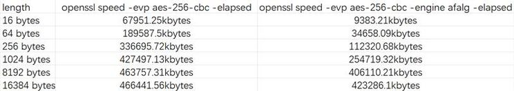

hi,NXP
I tested the openssl software and AF_ALG engine (offload HSE), and found that the performance was worse after using the AF_ALG engine (offload HSE), Can you tell me why?
Here are the test data:
I used openssl's own performance testing command, the AF_ALG engine was not used on the left, and used on the right. I checked and found that there was indeed an increase in HSE interrupts when use AF_ALG.
 This is test of hash, left use openssl EVP api and right use kernel socket

Daniel-Aguirre
Thanks for the information. Could be that there is bottleneck when sending the information to offload with HSE. Could be that the offload still requires some optimization.
Still, we will confirm if this behavior is expected or not. Can you help us with the measurements of the 16, 64, 256 and 1024 bytes? Unless we are not understanding the tables you have shared, we find that the first has different lengths than the second one.
Please, let us know.

eone
hi,NXP
the first data table is the performance test that comes with OpenSSL: the amount of data that can be encrypted per second, which clearly shows that pure software has a higher than offloading throughput compared to HSE.
The second table shows my time consumption testing of the interface. I did not test according to the bytes provided by OpenSSL, but calculated a byte change myself, which is consistent with the throughput results. The time consumption of pure software interfaces is much lower than that of HSE  hardware offload.
If that's the case, using HSE offload sacrificing performance. According to the link you provided, the performance of hardware processing large bytes should be better than that of software?
and then, Can I use HSE to accelerate openssl software algorithm operations?
thanks!!!

Daniel-Aguirre
Thanks for your feedback.
We know understand the 2 tables you have shared. Thanks for the description. The link we have shared was just an example of an open-source project, but it is not NXP developed, for what we can see.
Offloading to HSE should improve the performance, but this is by using the NXP Crypto API. As said before:

We have received the following update:
"When the AF_ALG engine is used, the software overhead is increased due to HSE driver and data exchange between linux kernel and user space. So, not surprise you got worse performance when using AF_ALG engine, specially for small data chunks.
I'm not sure about your use case. The top advantage of using HSE is the security, but not the performance. This is not to say, the performance of HSE is low."
For looking into the HSE benchmark, we can recommend sending the inquiry to your local NXP FAE/DFAE, for them to process the request. We do apologize.

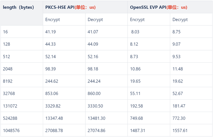

eone
hi,NXP
thanks for you feedback;
I conducted the following experiments based on the BSP36 guidance manual.
use the HSE reference link provided in the BSP36 manual: https://github.com/nxp-auto-linux/pkcs11-hse AES crypto was performed on data with different bytes, The code for AES_128_CBC testing is as follows:
At the same time, the same encryption and decryption code for the openssl interface was written, as follows:
Both scenarios were tested 10000 times and the average value was taken. The results showed that OpenSSL performed better at any length. The following are the statistical results of the test:
The performance of the pkcs_hse.so provided by NXP test results is also poor compared to the openssl software algorithm. Can you help confirm whether the test data results are normal?
and may I ask what the reason is?

Daniel-Aguirre
We may be misunderstanding your implementation, but looking into the provided HSE Benchmarks, we see that, even if HSE might not surpass OpenSSL, it should be closer than the results you are showing.
Again, could be we are misunderstanding the implementation.
Since HSE-FW information is confidential as well as the benchmarks themselves, help us contacting your local NXP FAE, for them channel this last request for either a reviewal of the implementation or access the test setup of the benchmarks, if possible.
