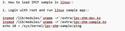

After that, I tried loading the IPCF drivers on the A53 side by following the steps from the S32DS M7 IPCF example documentation.
The ipc-shm-dev.ko module loads successfully, though it logs the expected warning:
[ 42.983443] ipc_shm_dev: loading out-of-tree module taints kernel.
However, when I try to load ipc-shm-sample.ko, it fails with a synchronous external abort.
For reference, I built the drivers from the SW32G_IPCF_4.10.0_D2405 branch against our current kernel version (6.6), and the M7 core is running IPCF firmware version 4.10.0.

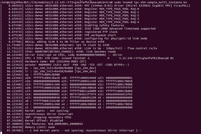

We built the drivers from the Yocto source, but the issue still persists.
Next, we rebuilt BSP 40 along with the driver and attempted to load it. However, we encountered the following error:
Q1: Does the M7 firmware need to be loaded before the driver can be successfully loaded?
Q2: Which of the following drivers should be loaded, considering we're using the IPCF_baremetal firmware (not the multi-instance variant)?
Q3: What is the root cause of the error we’re seeing, and how can we resolve it?
>>>Yes, you need to load M7 firmware before load the IPCF driver in kernel.

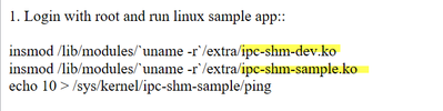

>>>The IPCF driver should match the M7 IPCF application, you can choice the M7 application of sample and multi_instance.
>>>You should make sure you have the correct M7 application using.  Also, you should have the correct sequence for loading driver of IPCF in kernel. Like the sample driver, you should add the ipc-shm-dev.ko and ipc-shm-sample.ko.
