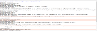

hi everyone,
I want to run sample IPC project from S32DS, i installed ipc extension but while compiling the project i got error which says ipc-shm.h file not found as follows:
I created project from example project and entered *.mex file which direct a new tab and in this tab i generated files by clicking following button:
I do not know whether ipc-shm.h must be generated or created manually? in documents there is no such comment.
Could someone help me on this topic?

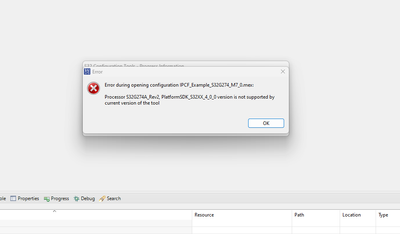

0xEC
after uninstalling RTD_4.0.1 and installing RTD_4.0.0, i got following error
8,757 Views
Daniel-Aguirre
We assume you are using the same IPCF example as before. If so, it will be locked to RTD v4.0.1.
If the project had any modifications you require, you can leave it, no problem, but you need to import the same project for RTD v4.0.0. Since there might be problem with the naming (if you leave the previous project) you will need to modify the example name.
Please, let us know.

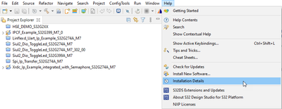

Can you share your "Installation Details" for your setup?
It seems that there might still be remnants of RTD v4.0.1.
8,743 Views
0xEC
what do you mean by saying installation details?
I removed RTD v4.0.1 and install RTD 4.0.0 and create fresh ipcf example project and it gives same error. Then i also deleted the ipcf package which was installed while using RTD v4.0.1 and re-install IPCF package but i still got same error.
8,739 Views
Daniel-Aguirre
It is an option under the "Help" menu:

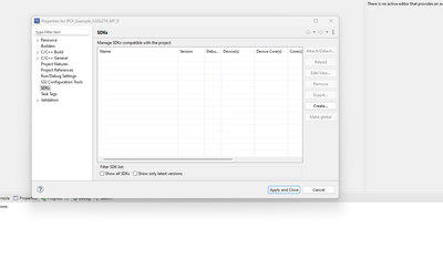

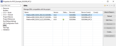

Also, you should be able to see to which RTD is linked our project by viewing it under the "Properties > SDK" menu, as shown below:
8,736 Views

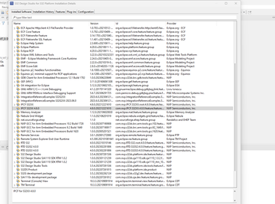

0xEC
installation details:
My ipcf project SDK tab is empty:
what is the problem in here?

Daniel-Aguirre
It seems as if the RTD has not been detected by S32DS.
Did you restart S32DS? We do assume yes.
Can you import a different project (i.e. Siul2_Dio_ToggleLed_S32G274A_M7)? Does the problem persist?
