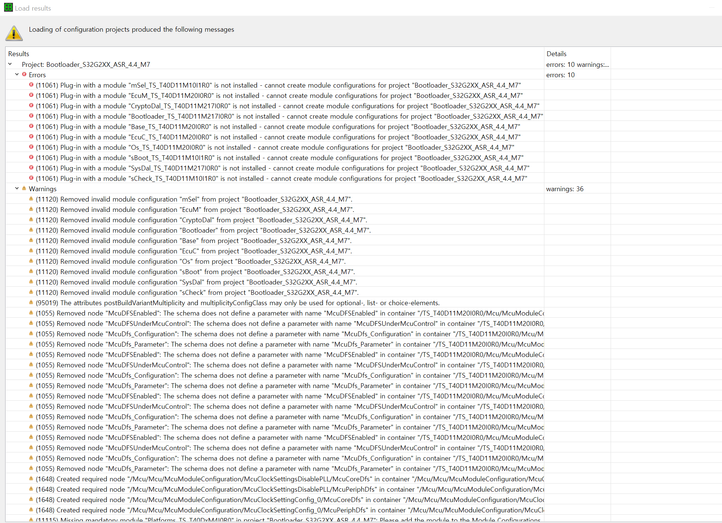

I have S32-VNP-RDB2 board and Bootloader_UserManual.pdf at Platform_Software_Integration_S32G2XX_2021_09.
I am trying to make a bootloader using Tresos tool by following Bootloader_UserManual.pdf.
I have Tresos import Bootloader_S32G2XX_ASR_4.4_M7 in Platform_Software_Integration_S32G2XX_2021_09.
But a lot of plug-in errors occur.
I think I need to get the relevant plug-in to avoid the error, but I don't know where to get it.

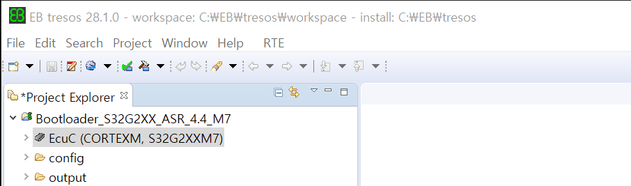

The workspace shown above reads "S32G2XX", but you are saying you imported the one for S32G3XX. Could you confirm which derivative you are trying to build for? Please also check that the software prerequisites are all met before trying to import the workspace.
Thanks!

I try to S32G2xx, but same issue.

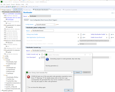

I also want the bootloader file to build, but the build fails.

From what I can see, your workspace contains changes that are not present in the original workspace. Please delete the workspace you currently have and import the release workspace as is. Otherwise, you are using it out of spec and we cannot guarantee the generation/build will work.
