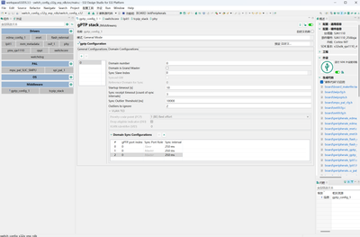

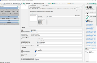

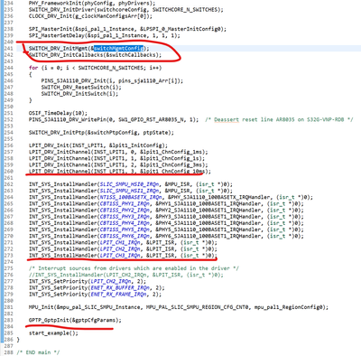

I have configured pfe0 to communicate with sja1110 port 4 through sgmii, and can ping. I want to synchronize the time between s32g and sja1110 through pfe0 and sja1110 port 4 interface.
Referring to the configuration of "gptp_sja1110x", I added gPTP statck on the "switch_config_s32g_vnp_rdb" and configured gptp. Finally, I compiled and generated flash_image.bin, renamed it to sja1110_uc.bin, and copied it to /lib/firmware.
However, after startup, I used tcpdump to capture packets on the pfe0 port, and no ptp-related packets were sent from sja1110 port 4 to the pfe0 port. Worse, I used pfe0 to ping 192.168.0.200 and got no response.
Here are my configurations and code modifications:
xiaoshumiao_0-1745834279558.pngxiaoshumiao_1-1745834304312.pngxiaoshumiao_2-1745834356302.png

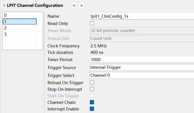

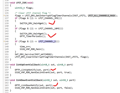

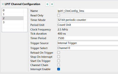

And I modified the configuration of lpit:
I called the function according to the instructions in the 'SJA1110 GPTP CONFIGURATION' document:
xiaoshumiao_7-1745834782067.pngxiaoshumiao_8-1745834909052.pngxiaoshumiao_9-1745834961626.png

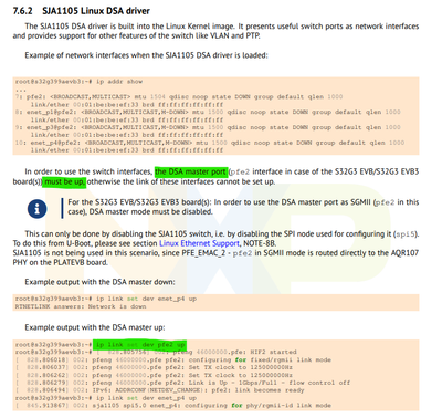

It is good to support you again. About your problem, in this community I can only help you with the S32G3 side, this means the Linux support for PTP protocol. You can check the BSP38 user manual section 8 PTP Information [page 73, Linux BSP 38.0 User Manual for S32G3 platforms, 02-Oct-2023], this section explains how to use PTP commands on Linux. In your previous post I did not understand that you wanted to route the PTP packages to Linux, therefore I was not able to mention the following note in the BSP38:
The Linux driver does support PTP messages, but not using the SJA1110. For this you will need to check section 7.6 Setting up SJA1105 switch, in particular subsection 7.6.2 SJA1105 Linux DSA driver [page 69, 70 and 71]. For more information please also check the Linux DSA official documentation: kernel.org/networking/dsa/dsa.html.

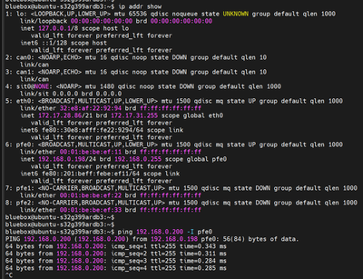

I used the unmodified 'switch_config_s32g_vnp_rdb' and flashed the firmware via JTAG port according to 'S32G-VNP-RDB3 Ethernet Enablement Guide'
But I still can't see the sja1110 network interface
2,554 次查看

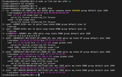

Hello @xiaoshumiao,
I see from the logs you shared that the PFE2 interface is down, could you try to configure it as mentioned in the BSP38 user manual and share the results?
Please also contact the SJA1110 experts in parallel, as I can only help you with the Linux side.

xiaoshumiao
hello @alejandro_e
There is no effect after setting
As shown in the figure below, to disable DSA master mode, you need to disable SPI mode.
I don't know whether the dsa driver is installed or enabled.
2,477 次查看
