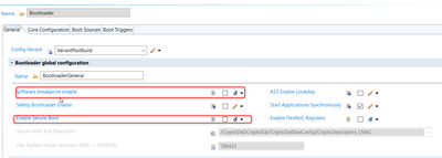

But when I unchecked two options as follows, I got the compilation error again.

Daniel-Aguirre
For the ASM_KEYWORD, this is related to disabling the Secure boot option:
"This is due to the header file  'Mcu.h' is missing when BL_CRYPTO_USED==OFF. After this is fixed, the bootloader can be compiled successfully."

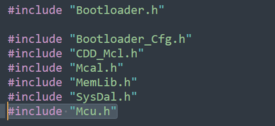

We added the header directly into the Bootloader.c file and can proceed on this regard.
Please, let us know.

superyyf
Thanks Daniel-Aguirre, it works.
After i directly add Mcu.h to Bootloader_Specific.c (not Bootloader.c), the error disappear.
