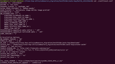

Greetings All,
We attempted to build the Linux BSP on a Ubuntu-18.04 LTS host, but encountered issues with the compilation.
Here are the steps:
  • get the meta-adas repository
mkdir ~/bin
curl http://commondatastorage.googleapis.com/git-repo-downloads/repo > ~/bin/repo
chmod a+x ~/bin/repo
PATH=${PATH}:~/bin
git clone https://github.com/nxp-auto-linux/linux-bsp-utils.git
cd /home/test/linux-bsp-utils/codeaurora_migration
./migrate.sh --full --work_path ./testfolder --release_branch release/s32v_bsp23.1 -m "adas.xml"
cd testfolder/auto-bsp/
./sources/meta-alb/scripts/host-prepare.sh
source nxp-setup-alb.sh -m s32v234evb
Download and install the VSDK archive VisionSDK_S32V2_RTM_1_7_0.bin
  • Edit the file conf/local.conf
  • Build the image
bitbake fsl-image-auto
But some errors occurred.
How can i solve the error?
Could someone share some thought on that ?
Thanks everyone !

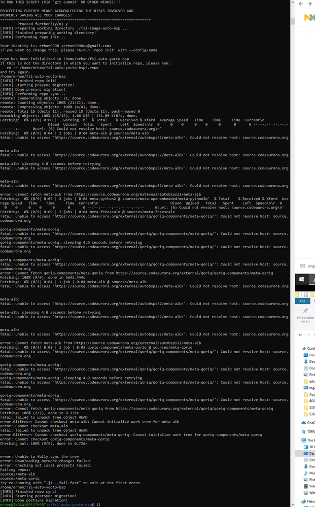

0xEC
this migrate.sh script is also tryig to reach source.codeaurora.org address which is unavailable. i got following error messages

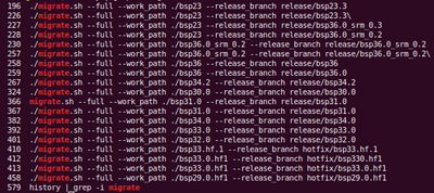

kiashade
Hi Erhan,
that NXP provided script did work well for us.
Maybe it helps -> below you see the BSPs we repo-ed using the migrate script along with full CMD.
Note 1: You can repo release/bspXYZ and/or hotfix/bspXYZ.
Note 2: Even though all migrate.sh based repos worked, bitbake failed in many cases - for various reasons. (We have yet to provide corresponding logs to Ionut)
Hope that helps a bit !
