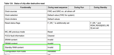

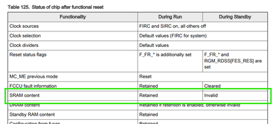

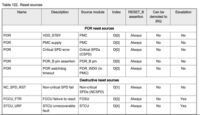

To know when exactly the SSRAM content is retained please check the section 28.7 Chip status on reset exit of the Reference manual [page 1150, S32G2 Reference Manual, Rev. 8, February 2024]:
Please check the reference manual for full information.

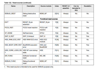

In the table I mentioned before you can see the resets that are of type functional:

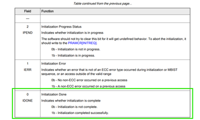

About the status of the SSRAM you can check the 35.3.5 Platform RAM Status Register (PRAMSR) register to know if it was successfully initialized and therefore can be accessed [page 1436, S32G2 Reference Manual, Rev. 8, February 2024]:

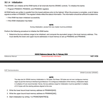

You can learn more about how to initialize the SSRAM in section 35.1.4 Initialization, under Chapter 35 SRAM Controller (SRAMC) [page 1427, S32G2 Reference Manual, Rev. 8, February 2024]:
My understanding is that with a functional reset (this is when the information is retained) the SSRAM should not loose the initialization status and therefore you should be able to read it without problems. Please note that the SSRAM depends on the STANDBY power domain (VDD_IO_STBY), so that voltage needs to be kept in order to retain the SSRAM data.

Checking the reference manual for the registers value for reset (MC_RGM_DES and MC_RGM_DES) which are read in function  static enum reset_cause get_reset_cause(void) [.../arm-trusted-firmware/plat/nxp/s32/s32cc/s32g/s32g_bl2_el3.c][page 1139, S32G2 Reference Manual, Rev. 8, February 2024] (please check the full table in the document for better reference):
I was not able to find any error directly related to the a SSRAM access. Please provide the following information to have better context of your setup:
