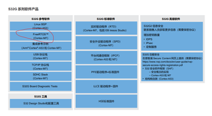

chenyin_h
Hello, @yangjinzhuang
Thanks for your post.\
1. On M core side, the software that NXP provided are listed below:
We do not directly provide AUTOSAR OS, but MCAL(RTD), most software packages provided for M core side are not open source.
2. There is not a unified UM like BSP UM of A core, but there are UMs in each of the software package.
Chenyin

yangjinzhuang
Hello Chen,
       I find that NXP support FreeRTOS for M core, but I can't find it in the software-package-manager webpage,  I only find the FreeRTOS 4.0.2 for Core A and Core M and it is locked.
     I want to develop on M core, so I have some questions as follow:
    1. Dose GLDBOX's M core running now by default? Is it has OS and running by default?I received the hardware and do nothing about M core.
    2.In the software list you provided, I understand that NXP only provide some driver:RTD,PFE,HSE,LLCE,  not provide OS(RTOS,AUTOSAR) like A-core's Linux-bsp, is my understand right?
   3.The FreeRTOS I see in the package manager is locked, it is for M core?  Can I develop base on it for M core? How can I buy it or only need NDA?
