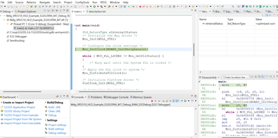

Dear team,
I am currently new to the watchdog functionality and am working on running the examples from the S32G3 AUTOSAR 4.4 RTD 5.0.0 D2410 Example Projects. Specifically, I am trying out the example named Wdg_VR5510_HLD_Example_S32G399A_M7.

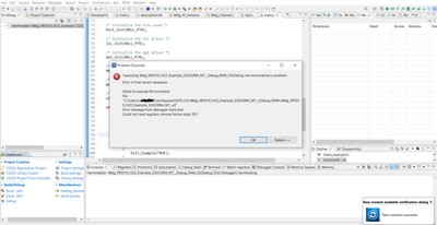

While I am able to successfully build the project, I encounter issues during debugging. Occasionally, the board disconnects automatically from the debugger, which disrupts the debugging process.

Edit to original post - During flashing Set SW10 switches to OFF positions: 1-ON, 2-OFF
Sometimes I am able to flash and debug.
Then I switched
Set SW10 switches to OFF positions: 1-OFF, 2-OFF

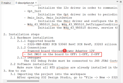

hi,honeybee1881
Thank you for contacting us.
Refer to the VR5510 demo description in RTD, you need to set SW10 on the board to OFF: 1-OFF,2-OFF.
Then, I can debug the demo normally.
Hope this can help you.

Yes, thats right
I made the SW10 to OFF as suggested.
