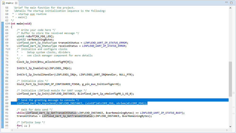

Let's first focus on the LINFlexD UART sample project. The welcome message is being sent asynchronously in this application, as highlighted below. To test whether this may be an issue with asynchronous send and/or with the use of interrupts, you can convert this send to a synchronous send such that the welcome message should finish printing before user input is accepted by the application.
To change to a synchronous send, you only need to change the highlighted function call with the following:
/* Send the greeting message to console */
    Linflexd_Uart_Ip_SyncSend(LINFLEXD_INSTANCE, (uint8*)WELCOME_MSG, strlen(WELCOME_MSG));

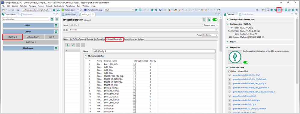

If the issue continues to persist, you can also experiment with the priority of the LINFlexD_1 interrupt, especially if you have other applications concurrently running on the other cores. To change the priority of the interrupt, access the interrupt driver configuration through the Peripherals ConfigTool, as highlighted below. Under the tab "Interrupt Controller", change the priority listed next to "LINFLEXD1_IRQn".
