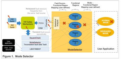

i am trying to integrate SAF module in S32g3. just wanted to know the recommendation where the msel module (mode selector which also calls scheck) should be integrated (in bootloader or in application software).
for now, im trying to integrate in application software, is it fine or it should be done in bootloader.

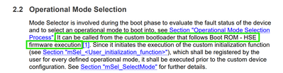

i understood! for performing test scheck should be integrated with Application software. what about msel module. that is responsible for selecting operational mode? should it be called in application?

Checking the mSel User Manual you can see that it is intended to be used in the Bootloader [page 6 and 7, User Manual, User Manual, Rev. 12.0 — 31 July 2024]:
