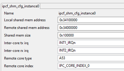

 My question is why the content written in M core in my shared memory cannot be read by A core, and the content written in A core cannot be read by M core.It looks like you're operating on two separate pieces of memory.The test code looks like this:
In M core after ipcf_init(), before remote_is_ready:
*((uint32 *)0x34100008) = 0xA5A5A5A5
In A core:
before ipcf_init():
addr = (uint32_t *)ioremap(0x34100008, 4);
shm_err("0x341000008:%x\n", *addr); //printk 0
So, for shared memory operations, do we need any configuration on the M core? Want to be shareable or cacheable_not?
7,657 Views
Quentin2022
I found that the partitioning of the SharedRAM in the link file caused, once I split the SharedRAM, then the A-core and M-core operations in this segment of memory looked as if they were independent.
I did A test, first use the default link file, partition SharedRAM address is 0x34000000, size 2M, then M core to write 0x34600000 address, in A core read the address out the correct value. Then I changed the partition of SharedRAM in the link file to 0x34600000, the size of 2M, and then read the content of 0x36000000. The A core could not read the value written by the M core.

fengxianeric
Could you please paste menu path for the ipcf_shm_cfg window for me ? thanks.
