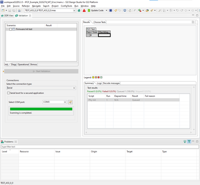

You can open/create a project for you S32 Device. After open ConfigTools and click on DDR

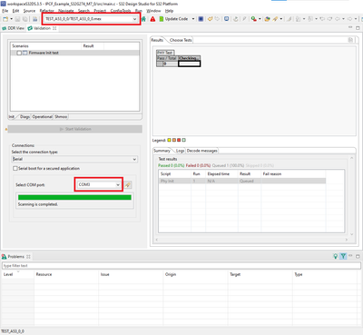

It will load a page like the next (it can be on the DDR View or Validation tab; you need to be on the validation tab):
Verify the project selected at the top. After select the port COM.
Check the Firmware Init test and click on Start Validation.
It will run and you can see if this passes or not. Please share the output you get here.

Hi @carlos_o ,
Sorry, it took long to setup the S32DS environment.
Here is the output from the DDR Test:
