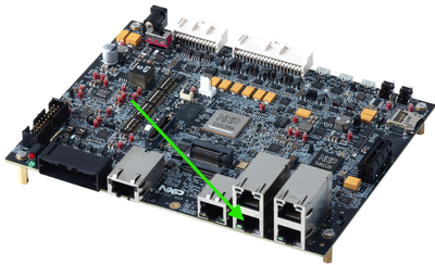

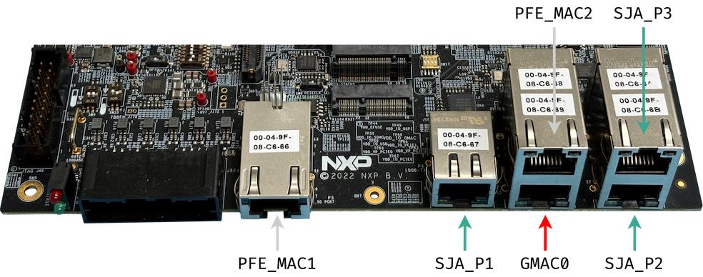

The PFE peripheral of the S32G3 has 3 interfaces, one is connected to the SJA1110 switch, and the other two are exposed on the board (PFE_MAC0 and PFE_MAC1 in the diagram).
S32G-VNP-RDB3 ports simple diagram.pngS32G-VNP-RDB3 ports simple diagram.png
My target application involves connecting clients to the board through both interfaces, and to synchronize with them with PTP. For this reason I need ptp4l to run with both interfaces, not just pfe1 or pfe2 separately.

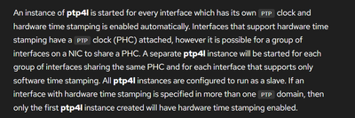

From the LinuxPTP documentation of the ptp4l tools, if I want to use hardware time stamping I read that.
All ports specified by the -i option and in the configuration file must be attached to the same PTP hardware clock (PHC).
So for this reason I need to configure the board such that both interfaces use the same hardware clock.

First I assigned an IP for each interface, then I invoked ptp4l for each interface and finally I showed the contents of the log files to the terminal.
For this I connected devices to both P3B (PFE2) and P3A (GMAC0), otherwise some error logs may appear.

Regarding the ptp4l documentation, please check the following:
Chapter 20. Configuring PTP Using ptp4l | System Administrator’s Guide | Red Hat Enterprise Linux | ...
It does mention that a group of interfaces can be started at the same time with the same instance, however, that is related to the ptp4l program, which is not provided by NXP and therefore we cannot offer much support, other than what we currently provide. Sorry for the inconviniences.

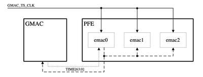

I have received the following feedback from the internal team:
If PFE_EMAC1 and PFE_EMAC2 share timestamp from PFE_EMAC0, it doesn't support to adjust PTP time of PFE_EMAC1 and PFE_EMAC2, you can think PTP time registers work in read-only mode. and reflect the PTP time of PFE_EMAC0. In this case in order to synchronize time you should use PFE_EMAC0.
Let me know if this information helped with your problem

My understanding is that the number of the clock in the output of ethtool is the id of the 'virutal device', and does not necessarily reflect the internal configuration of the module.
For each device a different clock device gets registered, it happens here linux-pfeng/pfeng-ptp.c#L247
for example, using the base BSP44 image, you can see all the PFE_EMAC instances register a PTP clock:

[    9.593027] pfeng 46000000.pfe pfe1 (uninitialized): Registered PTP HW clock successfully on EMAC1
[    9.653784] pfeng 46000000.pfe pfe2 (uninitialized): Registered PTP HW clock successfully on EMAC2
This clock register process gets iterated here linux-pfeng/pfeng-netif.c#L1544, for each interface.
You could modify the source code so that all the interfaces use the same virtual clock. Which is related to the information I shared before:
If all the PFE_EMAC interfaces register the same clock you may be able to use a single instance of ptp4l for all the interfaces you are interested in.
For more details you can use the following commands:
root@s32g399ardb3:~# ls -l /sys/class/ptp/
total 0
lrwxrwxrwx 1 root root 0 Oct  9 15:51 ptp0 -> ../../devices/platform/soc/46000000.pfe/ptp/ptp0
lrwxrwxrwx 1 root root 0 Oct  9 15:52 ptp1 -> ../../devices/platform/soc/46000000.pfe/ptp/ptp1
lrwxrwxrwx 1 root root 0 Oct  9 15:52 ptp2 -> ../../devices/platform/soc/46000000.pfe/ptp/ptp2
lrwxrwxrwx 1 root root 0 Oct  9 15:59 ptp3 -> ../../devices/platform/soc/4033c000.ethernet/ptp/ptp3
root@s32g399ardb3:~# ls /sys/class/ptp/
ptp0  ptp1  ptp2  ptp3
root@s32g399ardb3:~# ls /sys/class/ptp/ptp0/
clock_name  dev  device  max_adjustment  max_vclocks  n_alarms  n_external_timestamps  n_periodic_outputs  n_programmable_pins  n_vclocks  power  pps_available  subsystem  uevent
root@s32g399ardb3:~# cat /sys/class/ptp/ptp0/clock_name
pfeng ptp
root@s32g399ardb3:~# cat /sys/class/ptp/ptp0/dev
251:0
root@s32g399ardb3:~# cat /sys/class/ptp/ptp0/max_vclocks
20
This last part matches the following structure linux/include/linux/ptp_clock_kernel.h#L166.
Let me know if this information was of help
