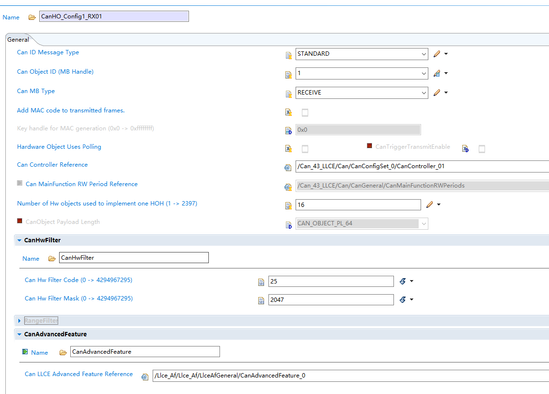

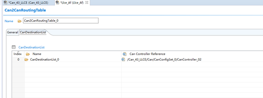

各位NXP专家,大家好!
背景信息:我的项目现在需要使用 LLCE 的 CAN2CAN 路由功能,从 BCAN1 接收消息将其路由到 BCAN2,绕过 Autosar CAN 通信协议栈。我已经按照手册配置了 EB,但测试后发现没有消息被转发。我的 LLCE 固件版本为 S32G_LLCE_1_0_7。HRH.pngHRH.pngLLCE_AF.pngLLCE_AF.png
调试后发现,CAN驱动初始化正常,路由表也设置正确,TXMB也足够。LLCE固定也已成功加载。所以我不知道问题出在哪里。请问您能否指导我如何进行故障修复,以及是否有任何合理的建议?

There is one more point that needs to be confirmed. The internal selection method of HRH in LLCE is as follows: first, search in the ordinary filter table based on the index; second, search in the advanced filter table based on the index, right?
For example, I created two HRHs on BCAN1. HRH1 does not associate with any routing options and does not filter packets. The generated code is a regular filter. HRH2 is associated with routing options and has a filter ID of 0x32. The generated code is an advanced filter. The object ID of HRH2 is smaller than that of HRH1. After testing, when 0x32 packets are received, they are always processed by HRH1, resulting in a routing failure.

A CAN message can only have one CAN ID, so it can only match one filter(In situation without CAN ID overlap), so the two filters are with CANID overlap? May I know the detailed settings of the two filters defined for one channel?

Hello,Chenyin
Yes, the two filters currently configured have overlapping messages.
HRH1:HRH1HRH1
HRH2:HRH2HRH2
We know that it is best to configure a filter for each message ID. However, since the project is acting as a gateway ECU, there are many messages and thus many HRHs need to be configured. This makes the work very tedious. So, it is sufficient to establish two separate HRHs for the routing messages and the host messages. However, from the results, the messages are always received and processed by the HRHs that do not have the relevant routing options.

For the situation you mentioned, the filter without advanced feature enabled will be firstly matched, which matches your testing results.
Generally, it is not recommended to have such overlaps in the configuration. It is better for each ID to have a fixed filtering rule.

1.We are using MCAL version RTD_4.4_4.0.2 and our own design board.
2.Thank you for your reply. The problem has been solved. Reducing the TXMB value used for routing on the target controller solved the issue; 16 appears to be the maximum TXMB value for each CAN controller.
3.I'd like to ask further: is there a way to disable the routing function of a specific CAN controller? Could you provide a relevant function or EB configuration option?
