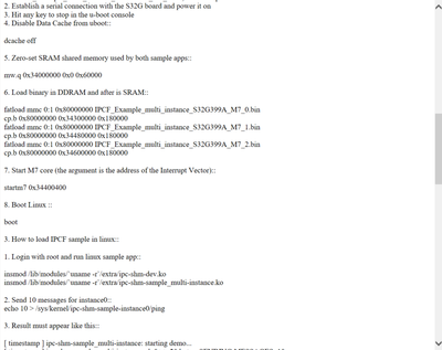

Joey_z
hi,liujian_abup
If you use the IPCF_Example_multi_instance_S32G399A_M7_0 demo in RTD,  you can do it to refer to the step as shown the following picture.
1.U-boot load the M core .bin file.
Refer to the content in picture to load.
2. insmod the .ko file.
It only has the M7_0 .bin, please ensure the load address correct.
Hope it can help you.
Joey
3,317 Views
liujian_abup
hi, Joey_z
It still crashes when using the insmod IPCF sample
The MCU has recreated it based on the screenshot you provided, and the load address is consistent with yours. The 7z file in the attachment is the sample I used for debugging here.
thank you.

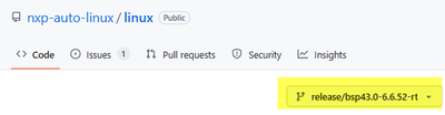

3,314 Views
Joey_z
hi,
Thank you for your reply.
I can not use your ipc-shm-sample_multi_instance.ko  file as the shown following picture.
Please check the uboot/kernel version on IPCF.
Joey_z_1-1747134637783.pngJoey_z_1-1747134637783.pngJoey_z_2-1747134646501.pngJoey_z_2-1747134646501.png
This is the way to compile the IPCF for .ko.
make -C ***/ipc-shm/sample_multi_instance PLATFORM_FLAVOR=s32g3  KERNELDIR=***/linux ARCH=arm64 CROSS_COMPILE=**/aarch64-none-linux-gnu- modules   4.10.0
Joey
