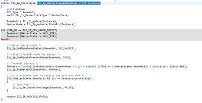

You can try to check the function of I2c_AsyncTransmit(0U, &pRequestSend);.
Then, it uses the function of I2c_Ip_MasterTransmitAddress(uint8 Instance) to transmint the address, the setting slave address will be left move one bit. You should make sure your slave that it can get the 10 bit address. And, you also can try to capture the master sending address.

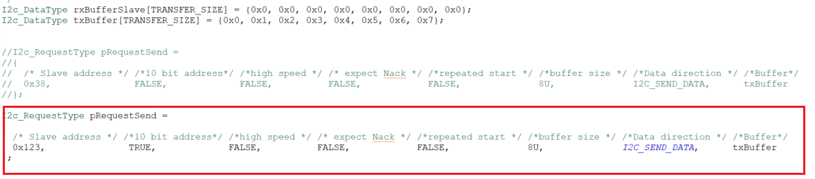

At present, the slave device supports data input with 10-bit address, but the nxp code only supports 8-bit number input. If I want to read and write data to 0x123 10 bit address, how should I write the code?
Is it as shown in the figure below, but I can't find this signal on the slave. Is there something wrong?

This function should be improved; I will submit this issue to the software team.
