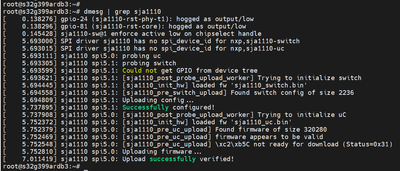

Hi nxp,

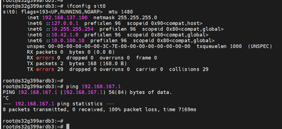

At present, we have built the S32G3 GoldVIP Yocto project. But we don't know how to use the test SJA1110. Can you tell me how to ping windows using the ping command? Or is there any way to test the performance of all network ports on SJA1110? Thank you!
I used the ifconfig command to configure sit0, but I couldn't ping windows.

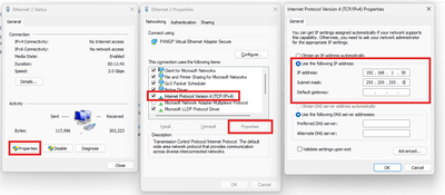

Once you boot this image you can ping your windows computer following these steps:

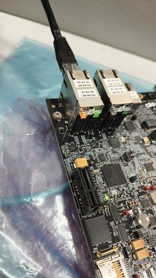

  • Using the same ethernet port you shared, connect the other end of the cable directly to your Windows PC.
  • Since you are not using a router/modem, you need to configure the IP of both devices statically
    • For windows (you will need admin access):
      • Enter Control Panel
      • Click on Network and Internet
      • Click on Network and Sharing Center
      • Click on the ethernet network connected to your board, for me it is Ethernet 2
      • Now you will see the following windows from left to right, click on Propieties, then on Internet Protocol version  4 (TCP/IPv4), then on Properties, in the last window configure the IP address and Subnet mask as in the image:
      • Press ok in all windows. Now the IP address of your PC is configured.
