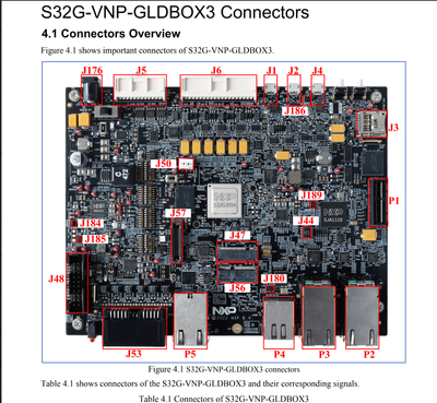

MrAlexIV
3,179件の閲覧回数
carlos_o
Thanks for sharing the board you are using.
For the GoldBox3, you need to enable the can0 and can1 nodes in the device tree. Within these nodes, you can configure which pins to use for CAN output. It’s important to ensure that the selected pins support can0 or can1 output in their SSS.
You could review which pins you could use with the schematic of the board and S32G3_IOMUX.xlsx file that is attached in the reference manual (you need to open the RM with acrobat reader to see the attached files)
