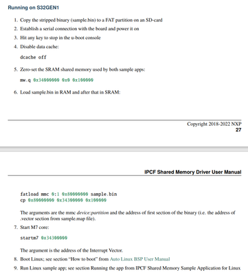

    I download BSP35.0,and reference SW32G_IPCF_4.6.0_D2205_UserManual.pdf,add the IPCF feature in  Image,  and the image has been built successful.
    This image has been burned to SD card,and image can be start normally.(Not hit anykey after power on the RDB2 board)
    But when I boot M7(bin file is IPCF_Example_S32G274A_M7_0.bin),and then boot linux,the kernel panic,how can i slove this problom.
IPCF UserManual:
Error Serial log:
=> startm7 0x34501000
Starting CM7_0 core at SRAM address 0x34501000 ... done.
=> boot
