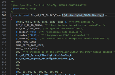

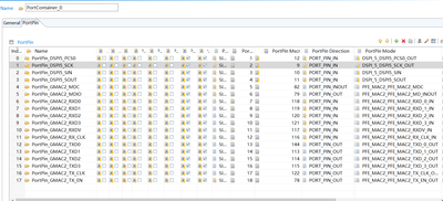

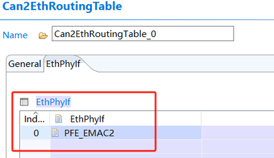

Since we need to achieve simultaneous startup of the A+M cores, the A core uses gmac0, which conflicts with pfe_mac1 used in can2net. We are now considering switching to pfe_mac2 for transmission. I have modified the EB as follows. After the modification, corresponding data has been input to CAN, but no network data is being transmitted from P3B. Please assist in troubleshooting;
Translated with DeepL.com (free version)
Change all can2net instances to pfe_mac2

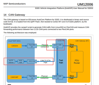

You can refer to the CAN Gateway demo in goldvip for the multicore LLCE.  CAN frames are transmitted from M core to A core via CAN2ETH.

I have solved the above problem by modifying the code and reading the data from pfe2.

I think you can focus on this structure.
