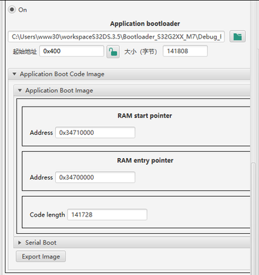

Hello, @PXH1
I feel very sorry for the delay.
Since you have run it without issues during debug,  you may try the value 0x34700000 as the ram start pointer.
Chenyin

PXH1
hello,
The above problem has been solved, now I have encountered a new problem, we are using the S32DS sample program, in order to ensure the normal operation of the boot loader program, I added the lighting program, debug everything is normal, but the download to norflash can not start.
Here's how I set up the IVT
