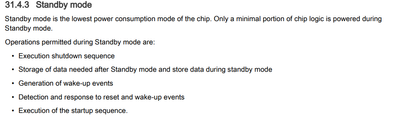

Within the S32G2 Reference Manual the following is said [Page 1370, S32G2 Reference Manual, Rev. 7, February 2023]:
Which ADC is not mentioned over the operations allowed during Standby mode. As for suggestions, there could be different solutions, one could be using an additional MCU dedicated to monitoring during low power modes.

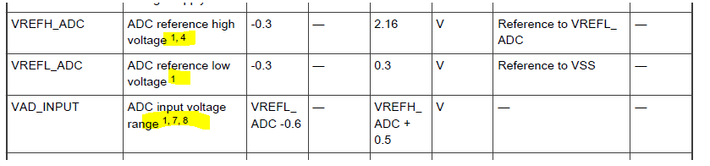

Looking through the details, I wonder if the recommendation in the schematic review is to take advantage of the highlighted portion below of note 8.
For me, the clarification is whether “device” means the whole SOC or the ADC block. If the IO pins of the ADC are not tied to an always-on rail, then for the standby case is that considered as “device is unpowered”?
Would you please advise?
Jacques
From the schematic review spreadsheet…
“In standby mode, please do not connect this pin to "always on" power rail. (e.g. VR5510 VPRE, VBAT)”
From the Datasheet…
3,562件の閲覧回数
